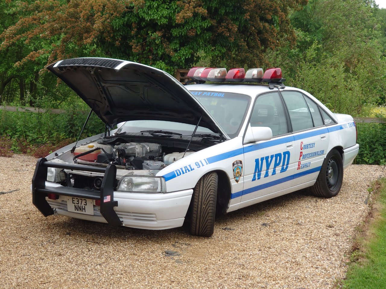

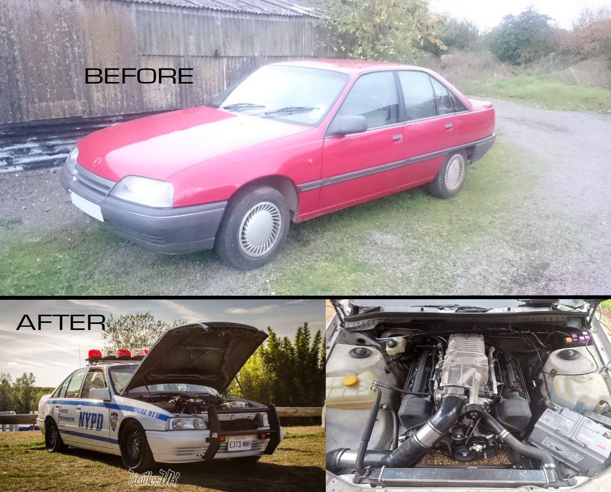

Here is my Carlton currently:
Before after.jpg (286.45 KiB) Vaadatud 24522 korda

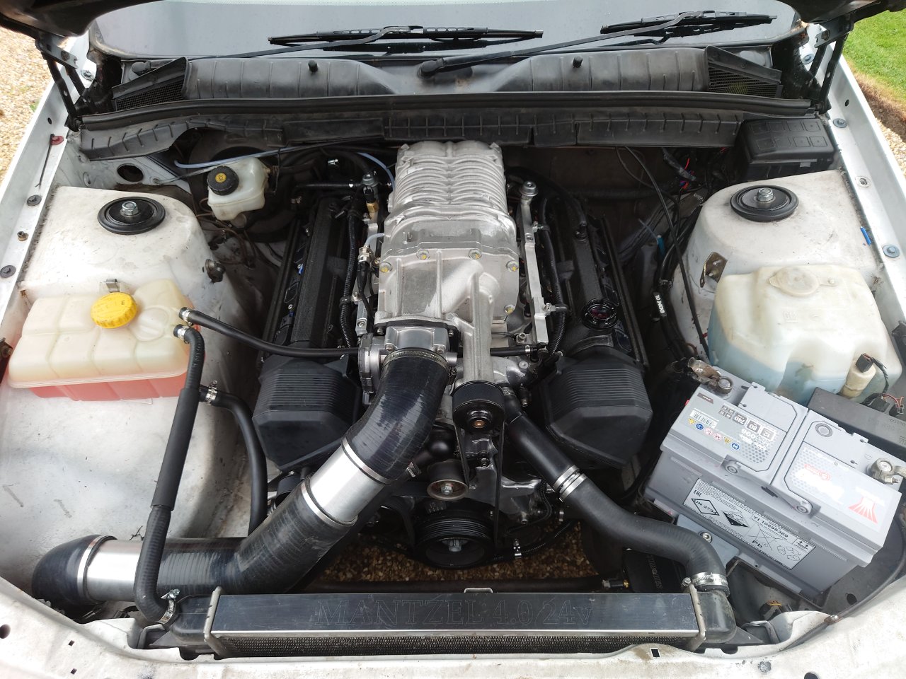

1UZFE 4.0 V8 from a Lexus LS400.
Eaton TVS1900 Supercharger
MaxxECU Race management system
405 rear wheel hp
Omega-B 2.2DTi manual gearbox
Vauxhall Monaro VXR rear differential
Steering box replaced with a rack and pinion steering system from a Corsa-C

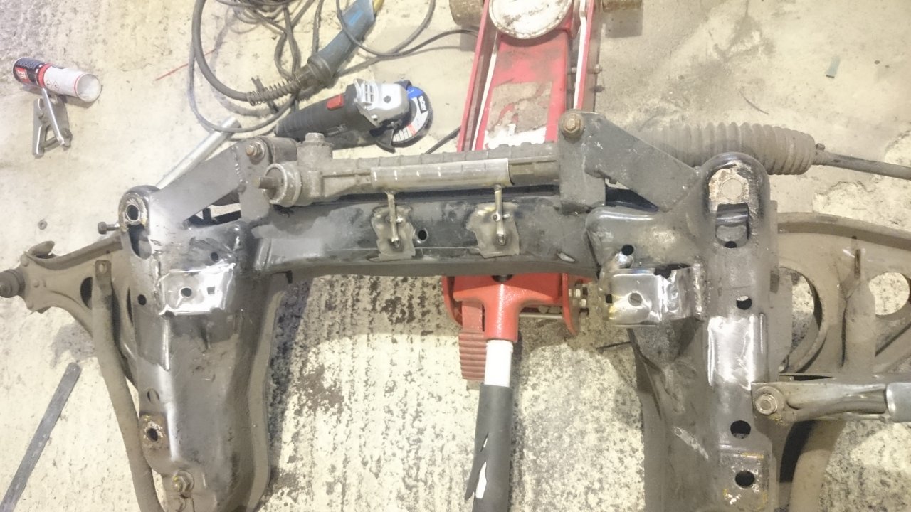

What car steering rack did you use?
Re: UK Vauxhall Carlton 1uzfe supercharged
Postitatud: 31 Jaan 2024 10:46
Postitas JohnnyA
risto002 kirjutas: ↑31 Jaan 2024 09:51 What car steering rack did you use?
Corsa-C. I used the steering rack and the electric column.
I did have to modify the tie rods and used Vectra-B ends

OT. Few days ago one guy from norway installed right hand BMW e39 steering rack reversed to left hand drive omega A.
Did you calculate your setup or just trow steering rack into there?

Martin kirjutas: ↑31 Jaan 2024 13:53 OT. Few days ago one guy from norway installed right hand BMW e39 steering rack reversed to left hand drive omega A.
I calculated it, the rack pivot points perfectly match the original pivot points so there is no problems with geometry. This is why I used the Corsa C rack, it's length is almost perfect to match the original Carlton.

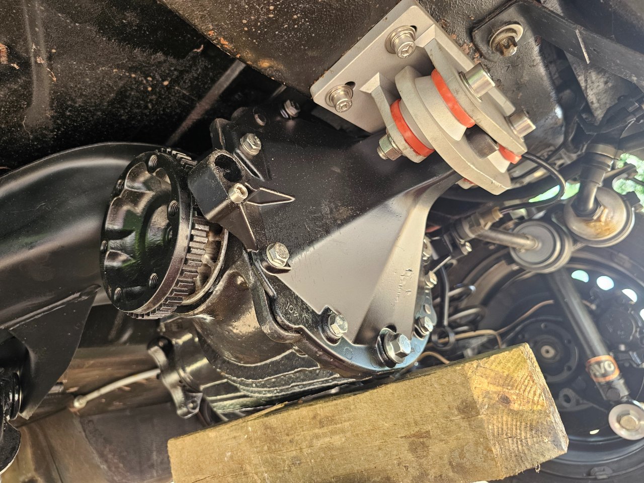

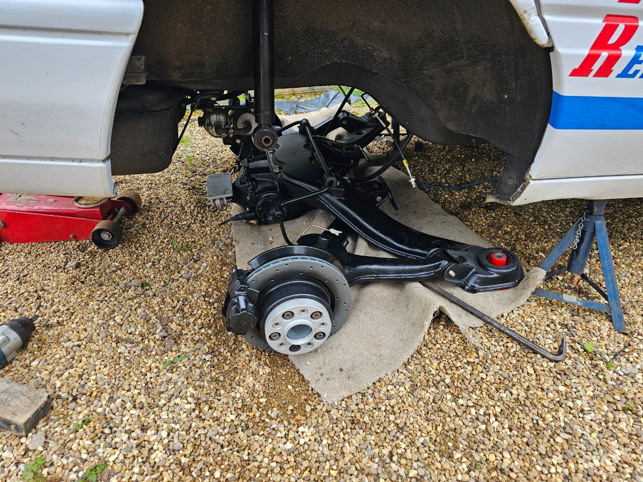

Refurbished rear axle going in
Postitatud: 09 Mai 2024 16:43
rear diff cover is custom made?
Postitatud: 09 Mai 2024 19:32
Postitas JohnnyA
Martin kirjutas: ↑09 Mai 2024 16:43 rear diff cover is custom made?
Do you mean the rear diff mount? No, it's a Holden HSV tuning part from Australia
