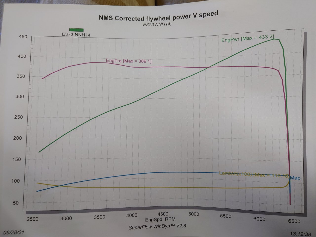

1UZFE 4.0 V8 from a Lexus LS400.
Eaton TVS1900 Supercharger
MaxxECU Race management system
405 rear wheel hp
Omega-B 2.2DTi manual gearbox
Vauxhall Monaro VXR rear differential
Steering box replaced with a rack and pinion steering system from a Corsa-C
